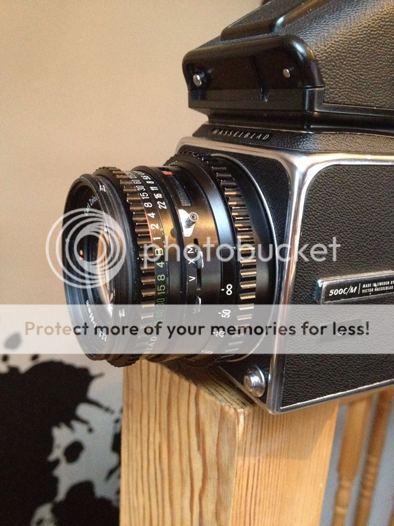

    all seems to work, and yes all you said makes sense Pete
    I few confusing moments ... but to be expected!

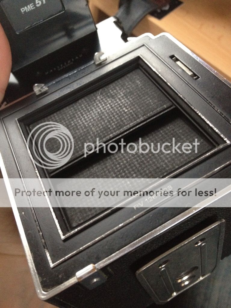

    one concern i had was that the auxiliary shutter can close before the leaf does ... i thought this might be a fault, but reading the instructions it does say that you should just hold the shutter button for longer when shooting at 1/15th or slower ...
    im also worried that the auxiliary shutter needs a lube as it doesnt shut properly until the camera is wound ... it sits slightly open like this
    [​IMG]
    I cant see that being an issue in the real world though as of course the mirror being up and the leaf being closed will keep light out ... right??

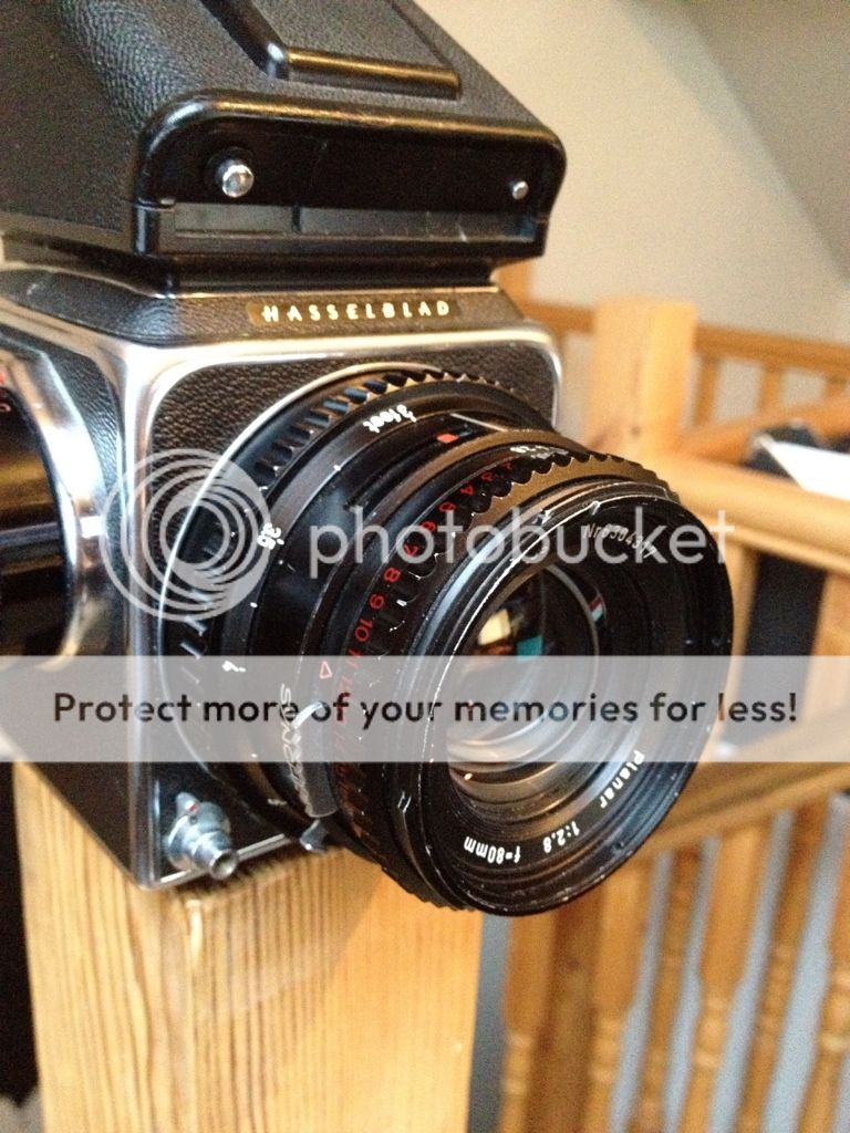

    I think it is an older lens ... ?

    Well the camera was made in 1981 (RV date code) and the lens was made in 1980. Ideally you need to sort out that rear curtain. Is the spring on it OK (moderate resistance when you poke it with your finger)? It won't so much of a problem with a prism finder but light can sneak round the mirror and fog the film in the back. It might free up with a bit of shooting. The body has obviously seen a fair bit of use as the light 'seals' are quite worn but this should be no problem. They were designed to take huge amounts of use although I have a 1980 body that still has the paint on them!! A useful tip is to always use the release lever when putting the back on rather than just snapping it on - it saves a lot of wear.
    I guess you've sussed out the coupling / decoupling of the aperture / shutter speed (pull the serrated tag back on the RH side of the lens to uncouple them while adjusting - later rings were decoupled by default and could be coupled if you wished). The DoF preview is the tiny lever beside the serrated one. To reset it you need to open the aperture and then re-close it. The lever below the flash sync lever is so you don't accidentally move it when shooting (I had a whole session ruined once because mine was sticking and I managed to move the lever to M without noticing!! - fixed in a service). The number scale in red relates the exposure index produced by the meter. It seems that the meter will read about 1 stop too low on a non-acute matte screen. I guess that will be easy enough to check.

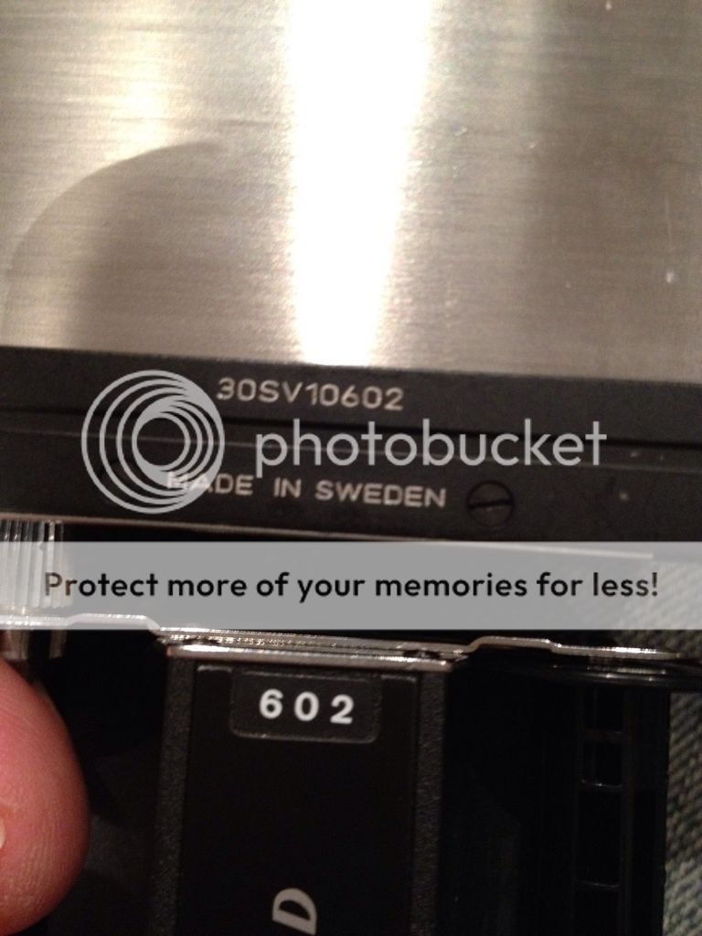

    Does the insert and the back match?

    Back and insert match

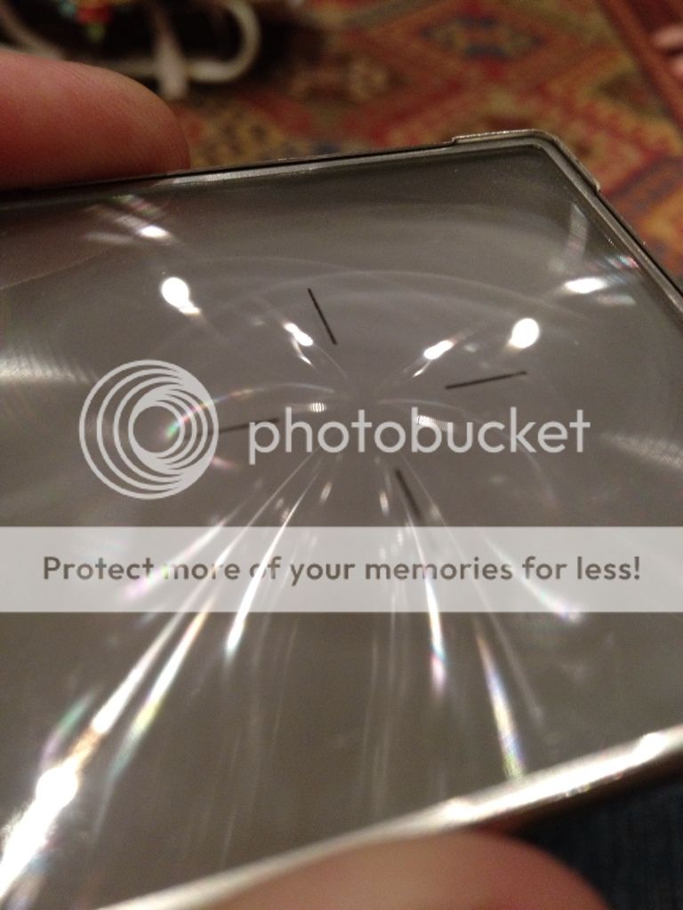

    Looks like it might be a accute-matte then
    [​IMG]
    There's def a fresnel pattern there ... I think ...???
    But that looks like a painted cross hair??
    So yeah as I said before I spotted your other posts .. Is there a split screen for it??

    That does look more like a standard screen. The Acute-Matte D definitely has embossed cross-hairs though (I just looked). I think I have a non-D screen in one of the bodies at work though. I'll check tomorrow.
