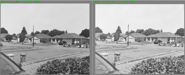

Still not thrilled. Toyo on the left f/32 @ 1/25th v. Sony on the right at f/22 @ 1/50th.
Maybe it is time to check out the lens.
It's probably my eyes.
Even using a 4x loupe and moving focus back and forth then splitting the difference, I'm not getting it.
I'm not sure how I would test the lens?
You aren't comparing like for like Gary. DoF with the digital is considerable greater than the 5x4 at the same aperture. The maths are beyond me but I would guess f32 on 5x4 is probably nearer say f8 on a 50mm standard. Have you done any sharpening on either of the comparison pair?
I sharpened the film shot and I'm not certain if I have the Sony setup to sharpen the sooc jpg, so I didn't do anything to it.
Am I expecting too much?

I believe that my gg was flipped. It is now positioned so that the ground side is towards the lens and in contact with the cut Fresnel which is on the inside.
