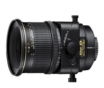

Some months ago Pete was kind enough to loan me his Nikon 45mm pce lens. today I got arround to using it for the first time for what i had wanted to borrow it for - perspective corrected architectural photography.

just to add... this is a very very sharp lens! not to mention how good it is when it comes to chromatic aberrations! very impressed ... I WANT ONE FOR MY OWN!
Yes, it's a T?S lens.

It is what Nikon call a perspective correcting (I think) lens ... So yeah, basically it is a Tilit shift lens

Tilt-shift (or Perspective Control, as Nikon calls'em) lenses are definitely a lot sharper as a rule than standard lenses - even compared to those of very high quality. They also have less CA, in general, and less distortion (neither barrel nor pincushion).
It's not unheard of to use 45mm or longer focal lengths for architectural photography. I use a standard 50mm prime sometimes and even use telephotos on occasion when I want to compress the scene and bring the background in close. But you'll find that shooting with a wide TS/PC lens is quite different in the techniques used and in framing and composition. As I said, the main purpose for a 45mm TS/PC is more portrait or product photography than architecture.
