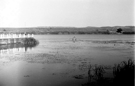

Colour film processed as B&W
That’s decent results. I did this once, negs came out extremely dense. Is that what you mean by ‘unprintable’?
I've done C-41 in B&W chems myself a few times. (Also Rodinal 1+100, 60 minutes, semi-stand.) Did a few rolls of slide film that way, too. I did these by choice, not necessity, though. Also did a few rolls of slide film in C-41 chems. I liked the color shifts that method produced.
