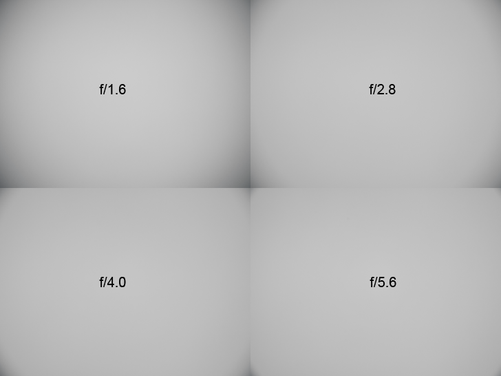

Hm, let's put this vignetting-sensitivity issue to a test. I've just opened MATLAB and read in the following f/1.6 test data: http://www.photozone.de/images/8Reviews/lenses/slrmagic_12_16/vig.png
I've removed the f/1.6 writing in the centre replacing it with the same bright pixels that surround the writing. For the mean intensity (integrating/averaging accross all pixels) I get 183/256 whereas the maximum intensity found in the center is 203/256. So the mean intensity/sensitivity of this lens is only 90% of the value in the centre.
So let's compare the 12mm SLR MAGIC at f/2.0 and the full frame 12mm Voigtlander f/5.6 which we assume doesn't vignet at all (image circle is 44mm, MFT diagonal length is only 23mm so this assumption is considered a good one). The difference in sensitivity is actually 7.0 (0.9*(5.6^2/2^2)) instead of 7.8. That's significant but not as significant as I thought. Note that I used the vignetting data at f/1.6, using the vignetting data at f/2.8 I get 7.3 (7.84*(186/198)) instead of 7.8 for the theoretical f-number comparison (mean intesity at f/2.8 is now 94%).
So we can finally say that instead of around a factor of roughly 8, the actual difference in sensitivity/light gathering power is only about 7.4 (0.92*8)!

I'm going to have to admit to be a bit baffled by your maths ..
But I want to ask one question
Looking at this picture
Does your maths take into account the way the light falls off ... Or it only effects the very corners and is not a gradual fall of right from the centre ... Like I say, I don't really understand the maths, but I can't see how you could calculate anything without measuring and specifically understanding the exact point at which the light fall of starts ... ??
Also, for my ease ... Can you translate the effect you are fining into the EV scale ...
ie the difference between 2.0 and 5.6 is 3 EV
2.0 - 2.8 - 1 EV
2.8 - 4.0 - 1 EV
4.0 - 5.6 - 1 EV
I understand that each time we move one EV we are doubling or halfing the light
Double 1, 3 times and you get 8 ... I understand that's where you get "a factor of 8" but fr me to translate "7.4" back to the EV scale is impossible for me as I am aweful at maths! :)
What I am trying to determin, is IF your maths is right then what effect on a camera meter this might have ...
